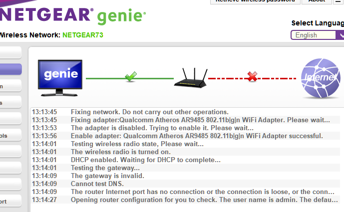

UPDATE: So when I plugged ethernet directly into modem, bypassing router, internet lasted <1minute and then would not come back up at all. As soon as I plugged back in to the router, internet immediately came back up. What's going on??
Below is a snap shot of the process commands that run each time I click on home internet button to "fix" int internet disconnect. Is there potentially an adapter issue?
