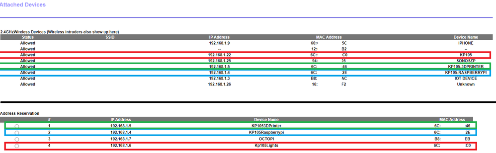

I have attached the current settings I have applied. The green and blue highlighted items seem fine.
The red one does not want to play ball and is the same TP-Link KP105 smart plug as the red and blue.
The reserved IP or custom name does not show for the device. As Soon as I remove the reservation for that device it connects through DHCP without an issue.
I tried simple names in case there was some kind of syntax issue, I tried plenty of alternate IP addresses and even lowered the range of IP's for the router from 1 - 100 (as I saw recommended in another thread. I have no idea why this isn't working.

  • Not sure why I can't edit my original post, but sadly this morning it started doing the same thing again, different IP address. Not saving the reserved IP 😞
