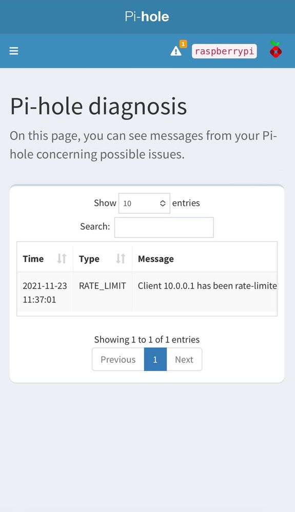

So, now the DNS request route is: Client -> Router -> DNS Server.
In my project has to be: Client -> DNS Server.
Bypass the request on the router.
I've found out it because PiHole returns an error, it blocks requests from router IP because they are too much for him. In fact this makes a DNS relay, so every request pass trought the router, not directly on the local DNS server.
This, in addition to generating the error on pihole, slows down the response to queries.
I know that configuring DNS directly on clients would fix, but I can't do it on every device on the newtwork... I want to be an automatic setting that DHCP server sends to clients, even when a new device is connected. Otherwise I have to use the DHCP on PiHole and not the original one of the router.
But not relaying on the router.

It tretunrs a RATE_LIMIT error (screenshot below).

It's related to the default pi-hole conf, that limit queries from the same ip (like 10.000 queries) per minute.
Pi-hole in this moment is receiving dns queries from the router and not from clients. So for him is only one client that is doing all these queries, and not effectively all single user by themselfs.
So it's called DNS relay...
