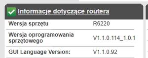

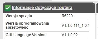

Netgear R6220 AC-1200 WAN 10M/Full - problem with autonegotiation
Hi, so shortly saying its look like my Router WAN port is autonegotiating to 10 Mbps when i have 100 Mbps from ISP. I've checked many different cables, made firmware upgrade to V1.1.0.114_1.0.1, don...
