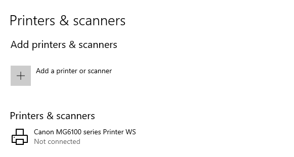

I am not doing anything active with the printer. To test connection, I open the Printers & Scanners tab and see if it is showing as connected or not. Additionally, I try and open the scanner on my mac. If I it shows disconnected on my Windows PC, the scanner has always failed to connect using the scanner utility. I am focused on the raspberry pi since I can run commands on it to identify any issues.

After resetting the configuration, I am able to SSH and connecting to the printer. The only weird thing is that IP Allocation does not seem to be working anymore. I suppose that's not the end of the world though.
