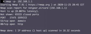

Ok here a screenshot of my ports i want forward:
And to my basic understanding, when this is set i should see that the port is open when i namp to the router via the local as public ip. But localy i get that the port is filterd and publicy i get that de port is closed.

Ok I added ports like, 22, 443 and 5900 that point to a specific IP. Then I did a scan with nmap to see if the ports are really open. Like: nmap -p 22,433,5900 192.168.1.1 Via the private and public IP you will receive a message that thee port state is closed or filtered.
With every other router I've ever done this, I could immediately see that the port was open. So what am I doing wrong or what should be on or off to get this working.

Ok, you keep dissecting everything I say and how I say it. The point is that I did everything according to the manual and the ports are still not accessible. Not via nmap and also not in other ways. Regardless of which ip they point to, my experience with other routers is that I can immediately tell if the ports are available when I scan for them. So please, do you have a solution or not? The other link you provide does not help either.
And by the way, when I scan for port 80, it does indicate nicly that it is open. so you would say that it should also indicate that for the ports that I entered it would indicate that they are open? But in contrast they are still closed.
