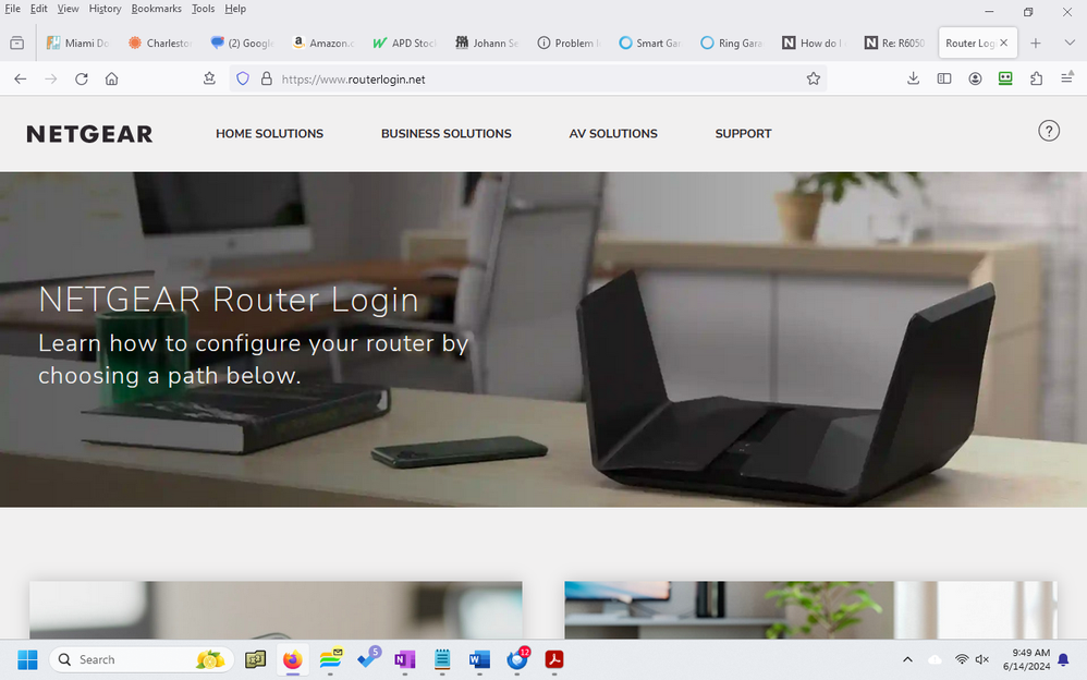

Don't know if this is relevant or not.
Since my last attempt to turn the 6050 into an AP, the APPLY progress bar got to about 90% and went to a netgear page I'll attach if I remember.
I now have two new networks listed - Netgear72-5g and NTGR-VMB-xxxxxxx. Neither connect to the internet. And I now have 2 more network connections showing - Netgear_5Gext and Netgear_24G_ext. I have the Netgear range extender on a table in my book case.
I can now NOT connect to the Asus nor the 6050 by 192.18.1.1, 10.10.10.1, or 10.10.10.3. All throw "unable to connect." I can access the internet through the Asus, but can't access the devices. Which means I can't find the settings on the 6050 to see if my changes finished or change them/try again. I'm getting tired of having to reset after every attempt. Currently, the Asus is connected to the modem wirelessly and the 6050 by cable.
