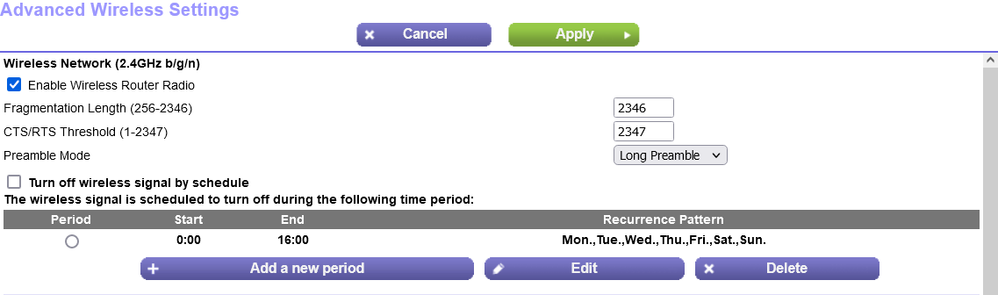

Just installed R6080 AC1000.  I cannot get the WIFI scheduler to work, there are a number of bugs:
1.  When I set the time to 00:00 to 16:00, select it, and click apply it shuts off the wifi, but the wifi never turns back on.  I have to turn it back on manually.  That makes the function useless.
2.  The next day, it did not turn off automatically.
3.  I cannot delete the schedule I've created.  I select the schedule and click delete.  NOTHING happens.
Note:  I upgraded to the latest firmware as of 9/3/22.
What am I missing?  I hope someone can help!!
Thanks, Phil

      Thanks for the reply!  My firmware is V1.0.0.54.  The router is connected to a Spectrum modem, model Hitron 2251.  Yes, I'm trying to setup the schedule under "advanced wireless settings".  Pic attached.  If I select the schedule with the radio button and check "turn off wireless signal by schedule" it turns off the wifi.  Also, when I try to edit or delete the schedule I cannot.  The buttons do nothing.  All of the other functions in other menus appear to work OK.

        One thing you could try is to avoid 00:00 as the time. This can cause problems with "clocks" that are supposed to roll over midnight. Use 00:01 instead. Also, use 23:59 for any "off" switch.
