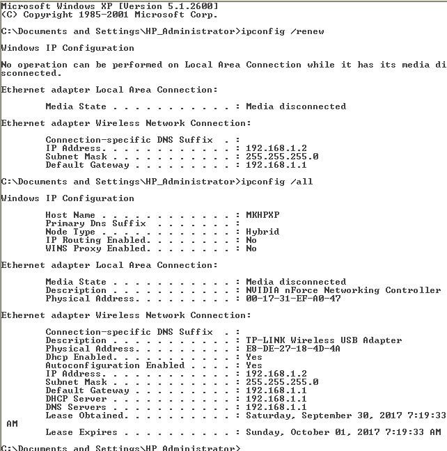

Does "desktop" mean a PC running some version of Windows? If so,
then in a Command Prompt (CMD.EXE) window, what does "ipconfig" say?
(Copy+paste the plain-text report.)

Here is my ipconfig data.- LongmireOct 01, 2017Aspirant

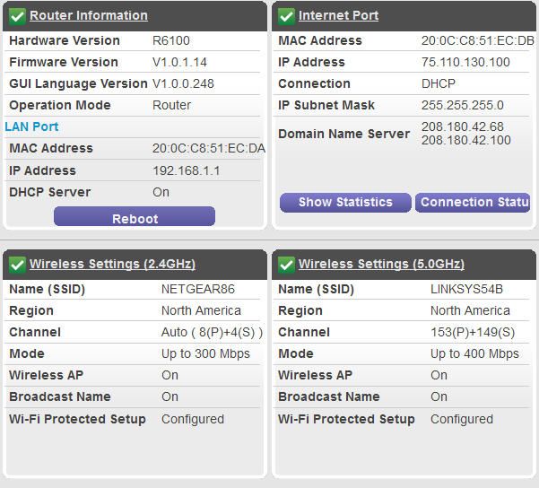

Here is my router data. The 5GHz access point is LINKSYS54B in name only. It is just my way of identifying it.

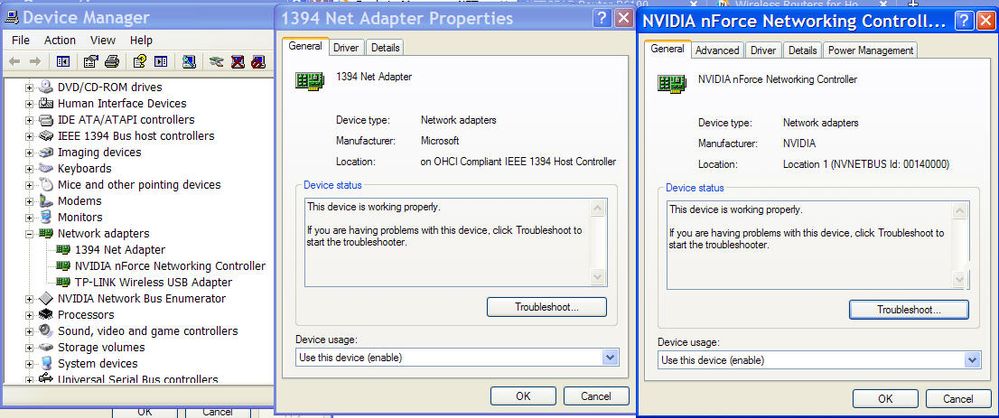

Here is a snapshot of my desktop adapter condition.
