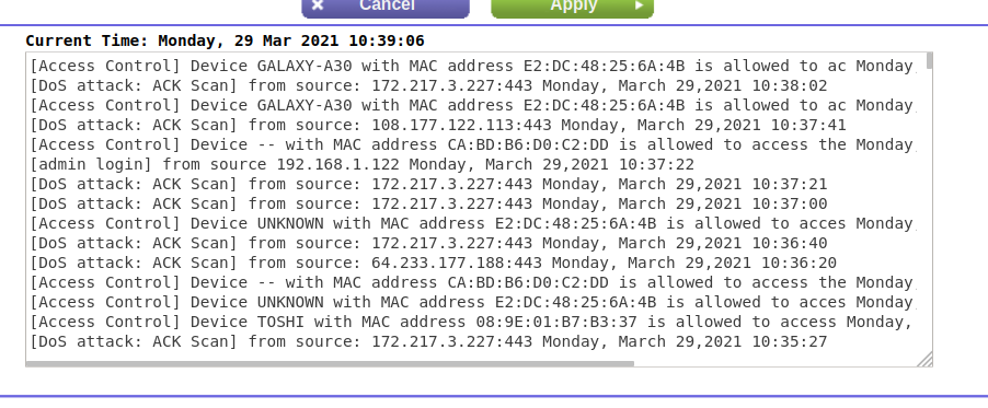

so the last week or so my internet has been pretty terrible. Mainly it seems to drop devices off, i often get messages saying that I'm not connected to the internet, or the wheel just keeps spinning ...

Theres a reasonable chance its the coax line from the isp. As I said, your power levels aren't bad but you have errors in the data. Plus the logs show errors with the isp.
You can always check your coax and remove any splitters, attenuators, or amplifiers. Check the link for kinks, damage, poor/cheap/corroded/bad connectors. Replace them if there are.
Then to covera ll the bases, you could factory reset and modem and the router and start fresh.
