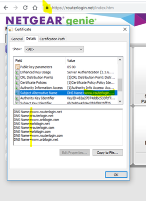

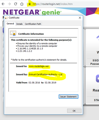

- schumakuSep 25, 2018Guru - Experienced User
vt460 wrote:
Based on the discussion above and further consideration, I've realized this would be terribly insecure:
caveat 1: local and remote management via https with the self signed R7800 certificate is not secure
... hopefully someday Netgear will add proper certificates with proper TLS support for admin login
Aehm, are you sure there is a self-signed certificate on the R7800 and the R6230? Most if not all Netgear routers, Nightawk, Orbi, Wireless Extenders, and the like come wiht a (shared, sigh ... yes) certificate and privage key - Issued and signed by the Entrust CA L1K, and supplied with a bunch of alternate subject names.
Of course, this certificate can't be validated for an IP address (as there simply an't be valid certificates based just on IP), or some custom DDNS names. But in general - to the documented domain names - this is a valid certificate.

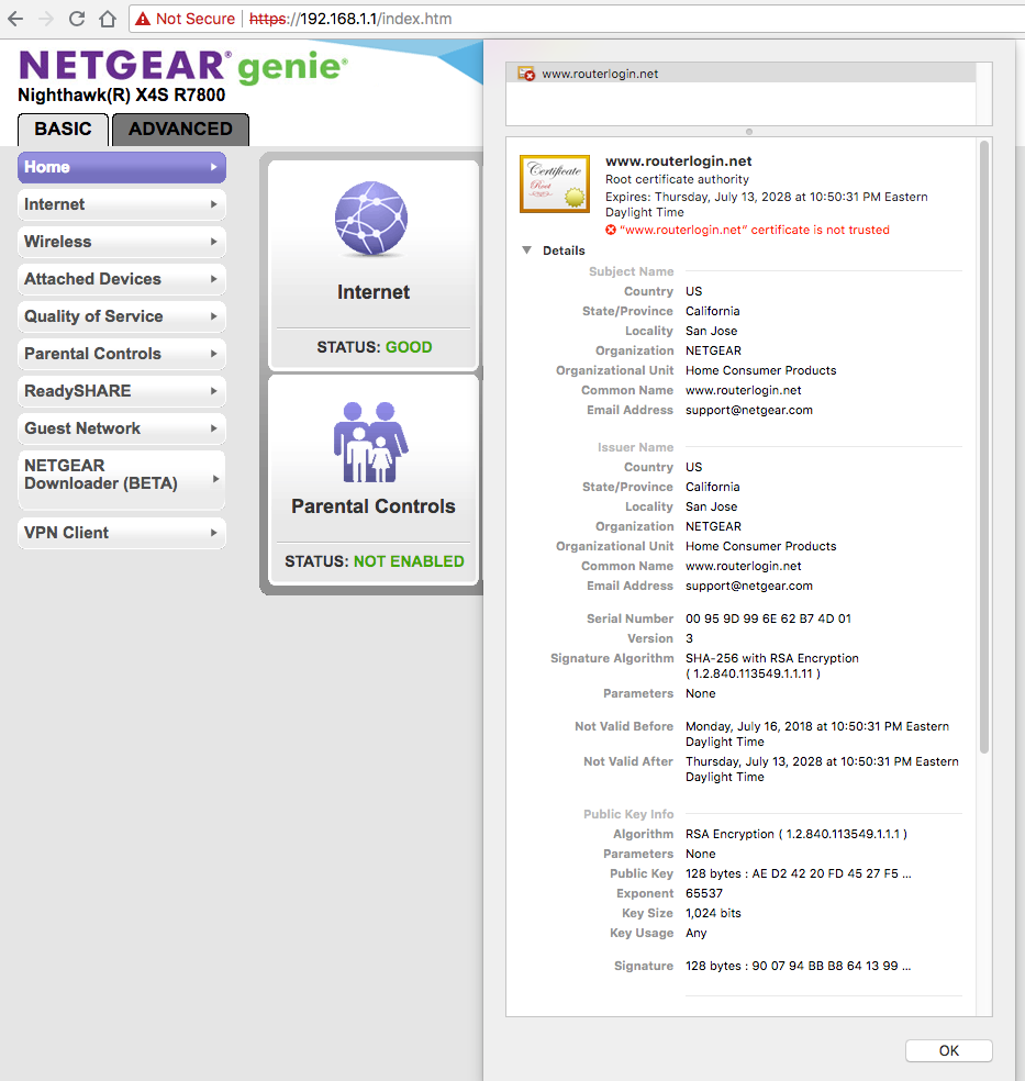

- vt460Sep 26, 2018Aspirant
I think I saw that the Nighthawk X4S R7800 certificate is self signed, issued by and to www.routerlogin.net - but I can't confirm right now because I'm not on that network, and, of course, I turned off remote management, so I'll double check when I can and post here
I did experiment with local DNS resolution for www.routerlogin.net and it did not help
I also realized that even if it did help, there's no obvious way I could make this work from the same laptop for both local 192.168.1.1 and my public WAN IP. But maybe I could resolve www.routerlogin.net to 192.168.1.1 and routerlogin.net to the public WAN IP, or something like that
The R6230 does not appear to offer TLS at all, but maybe there's a trick I don't know
