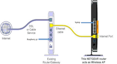

      I explain as simple as I could. in the small schema below. everything is hardwired.
      I connect a raspberry pi to an exisiting router/gateway that is connected to the internet and connect the netgear in wireless AP mode to this existing router/gateway.
      the laptop runs both windows and linux.
      when I run linux:
      the laptop cannot get an IP address from the existing router/gateway the packets do not even reach the router/gateway.
      this is obviously NOT normal
      I can workaround this issue by changing the dhcp settings in NetworkManager. But i shouldn't have to change any config to have this working.
      Once I manage to get the IP on the laptop. the laptop cannot ssh the raspberry pi which is connected to the existing router/gateway.
      To fix this I need to move the cable coming from the existing router/gateway to one of the lan ports of the netgear router.
      Since I moved the cable from the internet port to a lan port, when I boot on windows I don't have internet. I see errors on the existing router/gateway such as this:
      received packet on xx with own address as source address (addr:xx:xx:xx;xx, vlan:0)
      This is fixed by moving back the cable to the internet port on the netgear router.
      I tested with an other router the exact same topology, therefore I am quite confident that the problem is caused by the netgear it limits/blocks the lan port in some kind.
      therefore my question what is happening with the lan ports on wireless AP mode?
