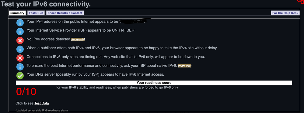

Current IPv6 Settings:
  • Auto Detected: 6To4 Tunnel

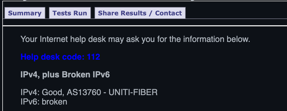

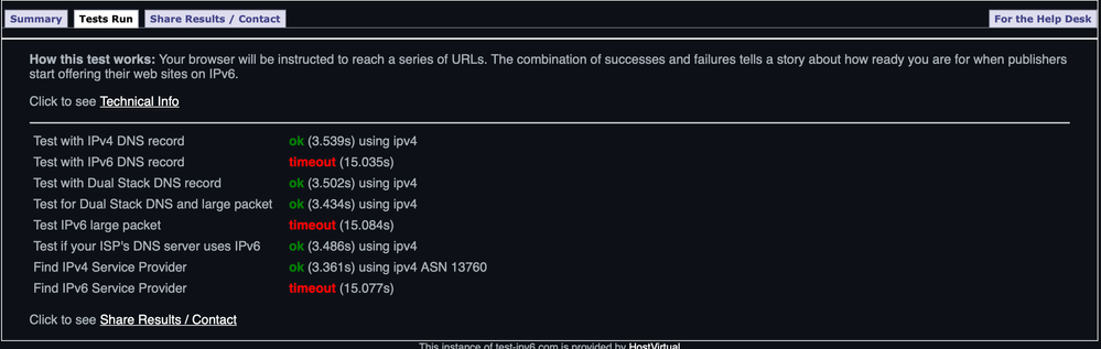

Also, if this helps some of you I came across this site that tests my IPv6 that is safe to share:

    Afraid, there is nothing (or not much) you can do - except of arranging your own unrestricted Internet connection, assigning a public IPv4 address to your router Internet port, and ideally providing a good IPv6 coverage, allowing your own IPv6 network on your router LAN.
    A hardcore approach would be to operate your "own" IPv6 network with the help of a tunnel broker https://de.wikipedia.org/wiki/Liste_von_IPv6-Tunnelbrokern, like HE's https://www.tunnelbroker.net/
    Said that: You get what you pay for...
