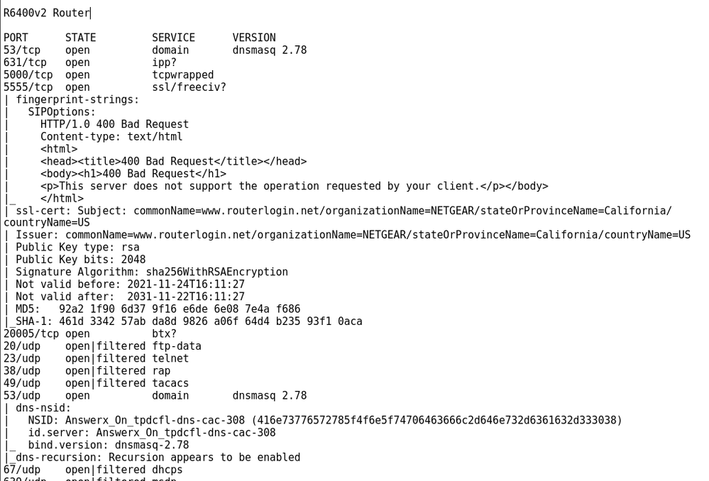

Yes, you are right, the router will change LAN ip address to avoid conflicts. That is not what is happening to me as my LAN address stayed at 192.168.1.1 and DHCP handed all my clients an address in that range. The WAN is at 74.x.x.x so ther is no conflict to resolve. If you are cascading routers, then you could have conflicts, but my router is connected to a simple cable modem. Nothing changed in the five minutes the update took to run. The web interface worked before the update, but not after the update completed. The R6400 router answers pings at 192.168.1.1 so the LAN is using that adress. I ran nmap and the http/https ports are not there, so the brower cannot access the GUI. Is the web service for the GUI running at a different ip address than 192.168.1.1 but everything else is running at 192.168.1.x? If that is the case then how would you access the GUI? All other functions are working on the router, so for now I am leaving it alone and next week will use tftp to revert to a previous version. I don't expect Netgear to care about my complaints, but there seems to be others having the same problems, so I expect they will eventually do something about it when enough users complain. Yes, it is my funeral, but Netgear dug the hole.
nmap port scan of 192.168.1.1. Note the absense of the standard web server ports (80 or 443). Please tell me how I can enble the ports so I can access the GUI.
- TvestraDec 24, 2021Star
Oops. the screen shot didn't seem to take, here is the nmap I refered to. Hopefull it will display.
