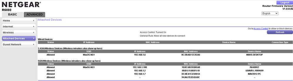

Here is what the R6080 sees before plugging in a laptop to the R6400v2:
After this test, I forced the R6400v2 IP to be 192.168.1.100 from the R6080 LAN settings to see if it would make a difference.   It did not.  So, don't be confused by that IP in the next shot, which is the R6080 view after plugging my laptop into the R6400 in a subsequent test:
There you see the hard-wired laptop (MAV2012-PC) and that interesting unidentified mystery MAC address.  I had to move MAVS-DESKTOP to the 2.4GHz band to have access to the internet.  USNVR-L1006... is unable to connect to the internet.

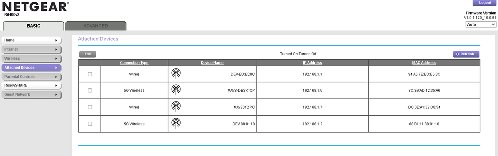

Here is the view from the R6400 at this time.
Note that the mystery MAC address is actually the R6080 MAC address.  I don't know if that's normal to see, or something isn't set right.
