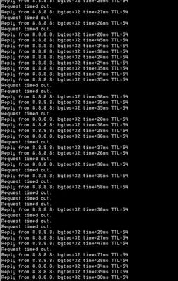

Random drops on R6020
Repost here since I thought it was a Nighthawk. So the connection on this will randomly cut out for up to 30 seconds at most at least once an hour, sometimes even thrice. I updated it to FW 1.0.0...

- DrakeSilvosOct 15, 2021Aspirant
Yeah I've gone through the motions with Spectrum and they said the modem is fine. And yeah this happens on wired too.
It's also happening much more frequently the past few days, possibly a result of me trying different channels I can't tell. At this point I'm just considering a new router.
