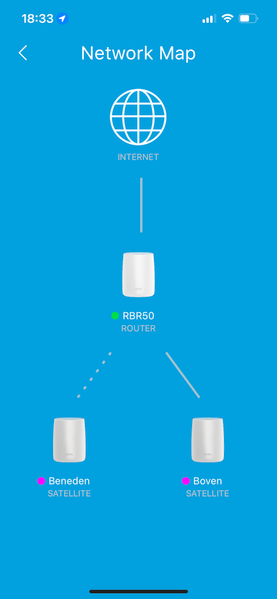

RBK 50 wired backhaul
I am struggeling with my wired back-haul set-up. I have devolo magic 2 powerlines (4). One has been installed near the RBR and had been directly connected with a cat 6 cable to the LAN port. 2 for...
plemans
Sep 28, 2021Guru - Experienced User
the color is indicating a poor connection.
https://kb.netgear.com/000061800/What-do-the-lines-and-colors-in-the-Orbi-Network-Map-mean
powerline isn't the best as many things can cause interference for it.
What color do you get if you connect an ethernet wire between the router/satellite?
(you can get a pretty long ethernet wire for pretty cheap)
Try connecting them to test out the connection. If it works fine, it indicates your powerline is the issue.
