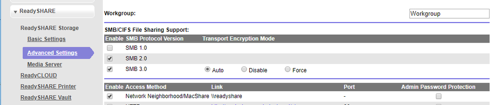

Some Netgear routers (I don't have the bigger picture) like the Nighthawk X10 (R9000) with the current v1.0.3.6 come with an updated SAMBA, and a UI control on the SMB protocols (plus some more) served:
