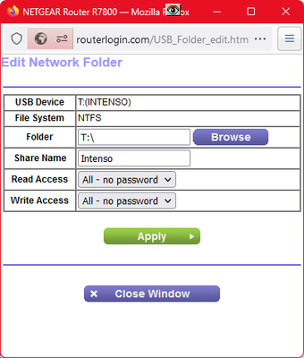

But, just to toss in my non-guru info - I think there was a firmware update that introduced the "USB_Storage" drive, that was formerly accessed via just a letter, "T" for instance.
That seems to be the same pattern as it always has been.
It depends on how you set up the folders in the browser graphical user interface (GUI). There are several ways of labelling attached devices:
There hasn't been any noticeable change in how ReadyShare works in some years.

In my vanilla setup - the drive was formerly "T:" and then it became by default both a "T:" AND a "USB_Storage", with all files then accessible via "USB_Storage". I didn't make any choice about it - I just accepted however Netgear wished to handle the drive. As a non-guru, I'm very hesitant to do anything that's not vanilla.
