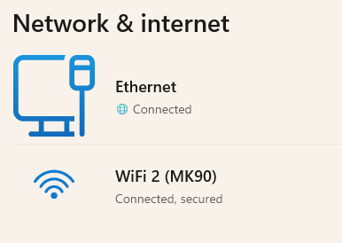

As my screenshot shows, the idea that Windows will use wifi or wired is just plain wrong. Heaven only knows where that came from. Maybe I misunderstood it.
If it were true, then anyone moving a laptop from place to place would have to reconfigure the PC whenever they moved it.

Unless you have some exotic operating system, running a wifi connection will not disable the ethernet link. Windows happily allows, even encourages, the two to coexist.
I run wifi and ethernet simultaneously. The idea that a wifi link will disable the ethernet link is astonishingly confused.
Please do not take that suggestion seriously before you do some experiments at your end.
