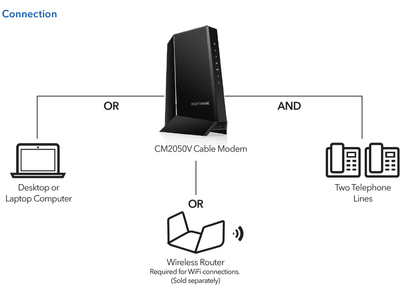

I connected my laptop directly to the single ethernet port on the modem but I do not get any connection. I spoke with Netgear Support who told me the CM2050V is only a modem, no router function within it so connecting a computer directly to it will not work. Must connect a router to it. I did not realize that when I purchased it so based on this I have no way to test a connection directly from the modem.
- CrimpOnDec 05, 2022Guru - Experienced User
See page 3 of the CM2050V Product Data Sheet
https://www.netgear.com/images/datasheet/networking/CableModems/CM2050V.pdf :
The CM2050V can be connected to either:
- One desktop or laptop computer, or
- A Wireless Router
Netgear support is correct. A laptop computer is not a router (unless the user has loaded router software on the laptop, which most users are not likely to have done). But, there is no need for a router to test the modem connection.
