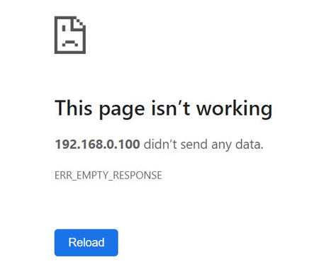

Unable to access configuration screen
Hi WAC124\AC2000 Firmware version 1.0.4.6 This device is registered within my Netgear account. I started having wifi connection issues with this device after about a years use. I decided to f...

To be clear, disconnect the WAN port from the internet and then log into the WAC124. It will log in using the local login instead of SSO. You'll need to do that for every login unless you block the WAC124 from accessing the internet.
indi-tech
Aug 26, 2021Star

Thanks your suggestion solved my problem but after a few days the SSO started working again. Either way my issue is sorted.
