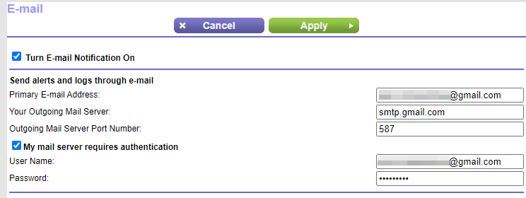

I have tried to set up the access log to be mailed to me when i have wifi breaches by a mac address not on my access list but, It does not appear to work. Does anyone know exactly how to set this up...

My experience is that some of these "workhorse" (does that make you feel more comfortable?) routers do not have the same configuration options as some devices with go-fast stripes on the side. For example, they do not allow users to chance the SMTP port from 25. Google no longer allows that port, if it ever did.
SMTP servers are also liable to changes as the people who run them beef up their security.
Look at the Outgoing Mail Server Port Number in your screen shot.
For Gmail, it seems that you need to use port 465. There are also authentication requirements.
gmail smtp outgoing server settings - Google Search
In my case, I do not use Gmail servers for SMTP from routers. There are plenty of other free email services that you can use.
In your case, it isn't clear if the problem is the gmail server, or smtp.live.com and its settings. That also seems to reject port 25.
All in all, your screen shots show a confusing muddle of severs and settings. None if which adds up to a working configuration.

JGL991 all recent routers can use say Gmail or Microsoft/Outlook/Live - and all support secured connections being on port 465 of 587 as well as the insecure 25 thanks to some brilliant simple sendmail implementation in place.
Some things in common for _all_ email providers nowadays is that you have to use authentication. You typically use the email address (of course the one fitting to the SMTP server, when consider to use the live.com SMTP you need to use some Microsoft platform Email, not Gmail of course. Unclear what does trigger the idea using a different email provider SMTP server than you intend to use as the email receiver. Of course this would work, but requires correct config for the authentication for that other email provider.
Another level of complexity is if your email account is two-factor enabled, then you need to generate an app password - the normal password can't be used.
Said that: Yes, you can use Gmail, you can use any Microsoft cloud E-mail, .... just configure the right required data.
- michaelkenwardAug 23, 2021Guru - Experienced User
And remember, the email address for the sender SMTP server does not have to be the same as the address you send logs to.
So you can use the outlook SMTP server to send "to/through" GMail addresses. And vice versa.
The important thing is to get the settings right. None of the screenshots from JGL991 are likely to work.
The first one is incomplete, likewise the thrd one. The second one does not seem to have anything to do with the problem.
The message from schumaku shows what you need to so. But the Primary E-mail Address: and User Name can be different. But they can also be the same.

Outgoing Mail Server, Outgoing Mail Server Port Number, and the authentication User Name and Password belong to the same group of the outgoing or sending mail server. The Primary E-Mail Address is the receiver address and can be different..
