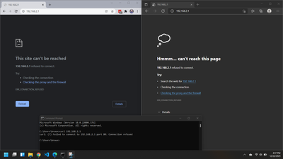

I did the manual install V1.0.4.122_10.0.95. The update completed, but instead of displaying the routers web interface it displayed the attached message. Now when I try to log into the router it imedantly displays the same message. When I use nmap on the routers ip address the http/https ports are missing. Everything else is working. the problem is, if you can't log on to the router, how do you apply an update. Looks like the tftp is the only option at this point. I have seen several posts compaining the they can't log on to the router after this update. Could Netgear have a bug?

I am experiencing the same issue as Tvestra after updating the routers firmware. Chrome (Windows & IOS), Edge, Safari (IOS) and curl all return their form of connection refused when attempting to navigate to the web ui (192.168.2.1, yes this is not the standard .1.1). Since the browser was able to access the web ui immediately prior to the firmware update and was how the update was initiated, I have a hard time believing it is an issue with the browser. The router seems to otherwise be functioning as expected. I have rebooted the router 5 or 6 times since the firmware update with no change. I have attempted to access the web ui from both wireless (both 2.4 GHz and 5 GHz) and wired connections with the same results.

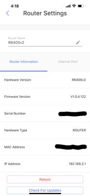

An interesting observation is that the Nighthawk IOS app is able to connect.
BrowserNighthawk App

As I stated before the problem is that the router no longer has the HTTP/HTTPS (80/443) ports open. If these ports are not open you cannot connect to the web server in the router. That is the problem. You are just chasing your tail doing a bunch of other stuff to try and connect as there is nothing to connect to. Please refer to the nmap run I did and you can see a lot of ports are open, but no 80 or 443. Port 5555 is running some kind of web service (maybe that is for the IOS app), so the web server running that virtual server. It looks like the server has a configuration issue. As long as port 80 or 443 are closed you will not be able to log onto the router with a web browser. The only solution I can see is to load a pervious version of the update with tftp as that port is still open.
