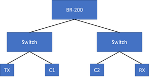

I am connecting two devices (TX and RX) to the same VLAN (VLAN 2) with my BR-200 following this schematic: Both TX and RX uses group broadcast (over 224.0.0.0/8), but they doesn't read eachoth...

OK, the problem was that C2's switch had enabled (under the 'multicast' option) 'Block Unknown Multicast Address'.
