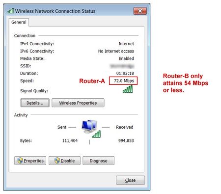

Wow! Thanks Antinode, I definitely wouldn't have caught that auto channel feature. Using a little utility called 'Wifi Info View' I was able to see that both routers were choosing Ch-4 in Auto Mode. I'm only showing the faster router on Ch-4 below and then I manually change the channel to 11 on Router-B (slower router). Also tried Ch-6.
I'm still not all together clear on why I'm seeing the Maximum Speed difference - where the red arrow is (that assumes Ch's 6 & 11 might be better). So Router-B was about the same using the Auto Channel 4 and manually setting it to 6 & 11 (my router goes to 11) :smileyvery-happy:
Some other oddities too (like the wifi type-PHY Type 802.11g/n vs 801.11g only - also auto feature?) and weird that the faster router seems to have a slightly lower signal quality and a higher Detection Count, which I'll have to school myself on.

Huh, in another topic thread, someone mentioned checking the WMM to on. Not sure why this worked when I have the same config file, but it did enable both 802.11b 'and' g which has correct the speed for the connection to the second router.
Thanks again Antinode, it would have taken a LOT of time stumbling around had I not started at the channel issue.

I think this is the solution antinode i.e., Under the Advanced tab/Setup/QoS Setup, the 'Enable WMM (Wi-fi multimedia)' setting was not saved in the config file. Not being checked prevented devices trying to connect via wi-fi, to not utililize the faster 802.11 protocol.
