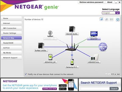

Do you think I should download the Genie App? I have it already, maybe it's been updated? I think Norton is blocking my download so far...It depends on what you mean by the genie app. Over the years, Netgear has put that label on various things. I am a fan of the desktop genie for Windows. (There's also one for Mac.) Netgear wants it to die, but some of us persist.
It is there on the downloads page for your router, but that link seems to be broken, which may explain what you see.
It is also here:
genie | Product | Support | NETGEAR
That has a very useful Network map.
