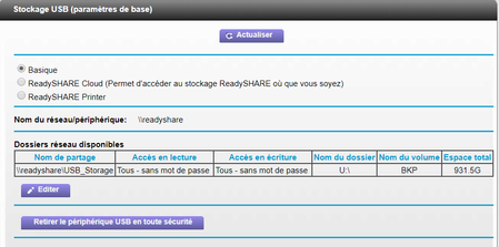

WNDR 4500 Can't connect to network drive \\readyshare\USB_Storage with Win 8.1
My Router WNDR4500 Firmware V1.0.1.46_1.0.76 OS on PC Win 8.1 Pro The router sees the device (shows the right size and volume name) but when I go in File Explorer to connect to a network drive...

I used your first sugestion/question and got to work. See the joined picture.
Thanks

1. Are you able to access it when using the IP address (\\192.168.1.1)?

Mchevrier1
Apr 09, 2018Aspirant
1. Are you able to access it when using the IP address (\\192.168.1.1)? See attached file
2. Was it working before? Yes, for years without any issues
3. Were you able to map it before? Yes, for years without any issues
4. Does FTP (local) access work? Yes
5. Have you tried using another storage device (flash drive, another external drive)? Yes, with no success. See attached file.
In File Explorer I see ReadyDLNA:WNDR4500
Through that I can see all the files, but when I go in FileHistory (MS Backup) to map the network Drive, WNDR4500 does not show. Before the problem occured, all I had to do was to map the network drive using File Explorer and point File History to that drive and my backups where done automatically.

Community Team- Mchevrier1Apr 16, 2018Aspirant
Thanks
