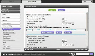

Check the section in the manual Advanced Wireless SettingsThe WNDR3400v2 is so old that it predates the official instructions:
How do I change my NETGEAR router to AP mode? | Answer | NETGEAR Support
But I have never seen any suggestion here that Netgear has made it impossible. AP mode is a basic function of routers.
Select Advanced > Advanced Setup > Wireless Settings
What firmware is installed on your router? If Netgear did disable AP mode, you can always go back to an older version that still supports that.

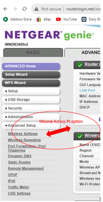

Thank you for the response. After looking at the manual and links provided in this thread, I went to routerlogin.net (see picture below). It seems to confirm the option to select Access Points is taken out of the current firmware. I am concerned about reverting to a prior firmware (not knowing the consequences). Any other option?

- michaelkenwardJan 03, 2024Guru - Experienced User
Solvenet wrote:
If Access Point is still a possibility (especially without going to a prior firmware), advice will be appreciated.
What is wrong with going to older firmware?
Remember, many router features do not work in AP mode.
Disabled Features on the Router when set to AP Mode | Answer | NETGEAR Support
This means that the router is not open to the security issues and other things that could hit your WNDR3400.
Your router is in charge of just about everything that matters, including control of the wifi devices on your network.
We are talking about a basic router from 14 years ago that you want to use for a limited set of features.
