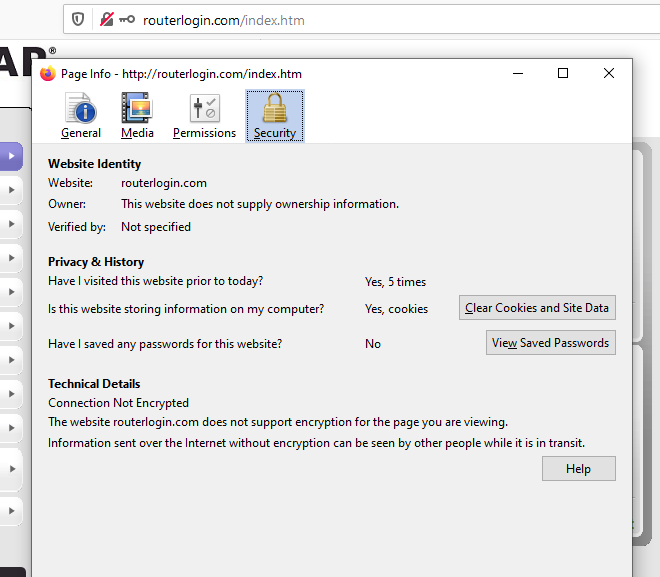

Retired_Member wrote:If I try to login to my router, I get a message it is a macilous site.
Really? Screenshot with the URL would be helpful here again.
Let's try to break this down into some details...
Most older routers only offer a http access - even the latest routers still allow http connection (reasonably secure on a private home and SOHO network. We can connect from a Web browser either using the router LAN IP address or one of these DNS-captured domains like routerlogin.com or routerlogin.net (and several others on different mode lines). Leaving the differences of the Web browsers alone (all say essentially the same, like "you are not securely connected" or "this site is not safe") when accessing a http Web site, the most informative (for me, not a Mozilla fanboy) is Firefox:
Here (and on any other common browsers) no word of a malicious Web site. Note: This is not Netgear's Web site - this is on our own local routers.
