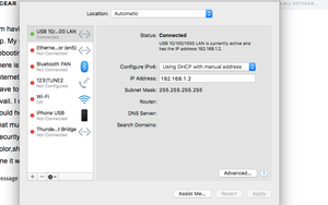

I am using a new Netgear WNR2000v2 to bridge a ubee modem/router to both my Macbook and Roku. Firmware is up to date. Setup: ubee is hardwired to netgear router. Router hardwired to Macbook via Belk...
- Aug 12, 2017
Was able to solve the issue by modifying both the ubee's range and my router's IP address as shown here:
http://vpncasestudy.com/download/usefuldoc/how_to_access_point.pdf
After these changes I reverted to "Using DHCP" instead of manual and it works!
griebs
Aug 11, 2017Aspirant
I was able to resolve the bizarre issue of resetting the router by making all fields manual. I also changed the WPA-2 password but my computer still cycles endlessly while trying to connect to it via Wifi.
Now the router detects internet through the hardwire (wireless off) and indeed connects to the Netgear dash, but I cannot access the internet. I tried unplugging both routers and power cycled correctly, even tried different browsers. I checked the two DNS servers on the working ubee dash and they match with those detected by the Netgear.
I tried connecting the routers via WPS on both their dashboards but neither recognized the other, and timed out. I even entered the PIN and MAC addresses but no dice.

- griebsAug 12, 2017Aspirant
