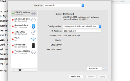

WNR2000v2 Connectivity issues
I am using a new Netgear WNR2000v2 to bridge a ubee modem/router to both my Macbook and Roku. Firmware is up to date. Setup: ubee is hardwired to netgear router. Router hardwired to Macbook via Belk...
- Aug 12, 2017
Was able to solve the issue by modifying both the ubee's range and my router's IP address as shown here:
http://vpncasestudy.com/download/usefuldoc/how_to_access_point.pdf
After these changes I reverted to "Using DHCP" instead of manual and it works!

griebs
Aug 12, 2017Aspirant
