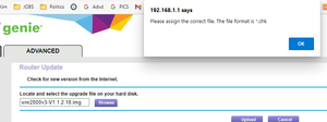

WNR2000V3 img file doesn't update
When I attempt to update my WiFi router, I download the file that shows on the Netgear website, it is a *.img file which the manuals says should work. Alas, it does not. As you can see below, it say...
not. As you can see below, it says the file format to use is a *.chk file. So, just in case, I copied the *.img file and changed the extension to *.chk, but that didn't do any good either.
Are you sure that you have the hardware version WNR2000V3?
The firmware for the WNR2000V2 is a .chk file. (No one ever accused Netgear of being logical.) And you cannot use V3 firmware on a V2 device.
MsDonCow
Jun 27, 2022Initiate
Well, that's embarrassing. My router was replaced and I forgot about it. It is an R6300V2 and I have updated my router. Thanks so much for reminding me to do the obvious . . . check the model.
Thanks,
Donna
- michaelkenwardJun 27, 2022Guru - Experienced User
At least the router didn't manage to install the wrong firmware. That would have been much more embarrassing .... and expensive
