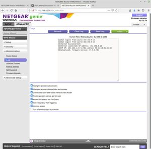

WNR2000v5 shows the Current Time: Wednesday, Dec 31, 1969 16:06:18 above log window.
Firmware version updated from v1.0.0.72 to v1.0.0.76 no change. Check out the current time above the log window. Anyway to check the router real time / date? txnintn
- Apr 12, 2021
Ok fixed it. I went to Security Schedule, Time zone was Pacific, I corrected it, then checked automatically adjust for daylight savings time and appied. Now the time and date over the log is correct. Weird bug.

- txnintnApr 12, 2021Aspirant
My main wireless router is a NetGear WNDR4500v2, it shows the correct time and date in the log files. The only LAN cable plugged into the WNDR4500v3 goes to the WNR2000v5's yellow port labeled internet. I have two desktops plugged into the WNR2000v5's LAN ports.
AP is manually configured simular to the article How do I change my NETGEAR router to AP mode after setting it up?
The WNDR4500v2 is DHCP 192.168.x.1) and the WNR2000v5 is on the same subnet, DCHP off and ip is 192.168.x.250.
Txnintn
