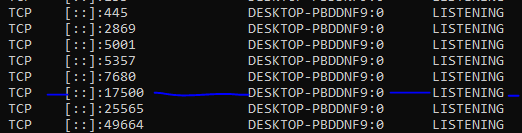

WNR3500L v2 25565 port closed
Good evening whichever human being stumbleing across my post.
I have recently been digging deep in making a minecraft server.
Although i can join and i have set up my port forward, my friend cant join the server.
When i go on websites to check that my port is open it says closed.
I have checked multiple times that the right IP address is being used, i have made rules in my firewall too.
My friend can see the server loading, and after that he disconnects.
We have tried multiple IP addresses, but none of which makes him join.
If you need any pictures just ask, i will kindly hand them to you.

    • Sunesh04's avatar
      Sunesh04
      I can join using my LAN IP address.
      The reason i can't join with my WAN ip address is because the port 25565 is closed.
      And i have made both inbound and outbound rules in my firewall.
      The routers IP and WAN is the following: Default gateway:192.168.1.1 and IPv4:192.168.1.150
      WAN could also be 109.56.132.21. Don't really know what to look for.
      I have recently reset my router to default settings.
      My friend has tried different IP addresses but the one which works the best is 109.56.xxx.xxx
      The IP i know is right is for my port forwarding, i use my computers Internal IP address.(192.168.)
      We tried to connect with different IP addresses to see which one would let us join the server, but all of them failed.
      Is there something i'm doing wrong with my port forwarding or is there something blocking my bound rules in my firewall?
