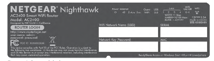

AC2400 is not a model #, it's a wifi combine speed value.
There should be a sticker behind or under the router that shows a R number value here.

There is, indeed, an AC2400 router. Look for it in the support system.
It was an odd lapse in Netgear's model naming system.
Support | NETGEAR
There is also an AC2100, among others.bbombassei has the latest firmware for the AC2400.
