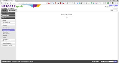

Access Control / Attached Devices not showing up
Recently I have been trying to access "Access Control" and "Attached Devices" from any browser when logging in to routerlogin.net. I can access all other tabs and links in routerlogin.net, but for so...

Doing a factory reset has fixed the problem. Thank you.
jbenjesus
Aug 08, 2018Guide
I did a factory reset and I was able to access both attached devices and access control. But the next day, lost access AGAIN!
So I did a firmware upgrade, but to the previous firmware patch. I did a factory reset and it worked fine. Then I lost it again the next day!
Not only that, my router's time on the traffic meter is 4 hours off my present time and I can't figure out how to fix that either.
Can anyone from Netgear support help me? I didn't do anything to this router for all this to happen, unless you count the firware upgrades it sends out.
