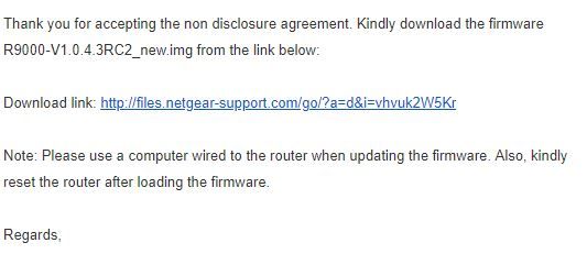

So I got in contact with an assistant that worked with Netgear and they managed to get me the steps of how to solve the issue.
The first thing they told me to do was to update the firmware to a new version that I don't think have been released yet.
The download link for that is http://files.netgear-support.
Download that and install it to your router, using a computer.
After it's successfully installed, go to your router and on the back off it reset it. It should be factory reset so that when you log onto your router, it would be just like new.
This was basically the steps I took in solving it.

- ChibiKevJun 21, 2018Tutor
I just did this, like 30 minutes ago. And yes, it is still working.
This was the firmware that Netgear managed to send me.- W4DRA-DaveJun 21, 2018Aspirant
