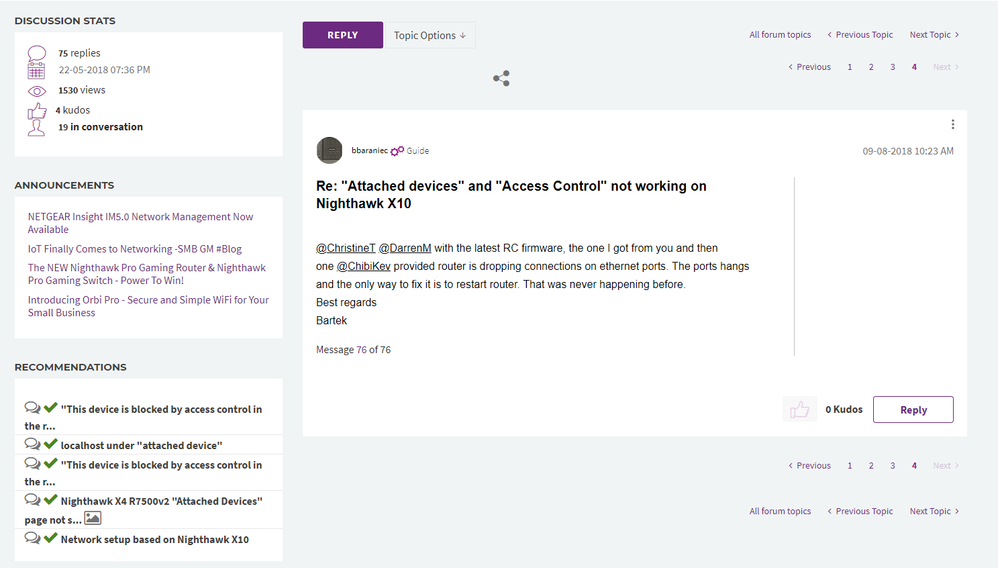

ChristineT I am having the same issues as bbaraniec . I cannot see any devices on the Attached Devices page. I also cannot see anything on the Access Control Page. Any Update on when a true fix may be released?
- ChristineTSep 10, 2018NETGEAR Employee Retired
Good morning redeliam,
I have asked DarrenM to work with you to get you the beta firmware for the R9000 that should resolve this issue. Please let us know if you are still experiencing this issue after you have installed the firmware so we can investigate further if needed.
Good morning to you too bbaraniec,
I'd like to take an opportunity to ensure we are both on the same page with regards to the issue(s) you are currently experiencing. I believe the beta firmware resolved the issue with Attached Devices, however, may have introduced a different issue with Ethernet ports locking up. Is that right?
We have created a new thread to track this issue separately under the following topic: R9000 Ethernet ports locked up on Beta firmware. This has already been escalated to engineering when it was first reported. Please allow me a chance to obtain an update for you.
