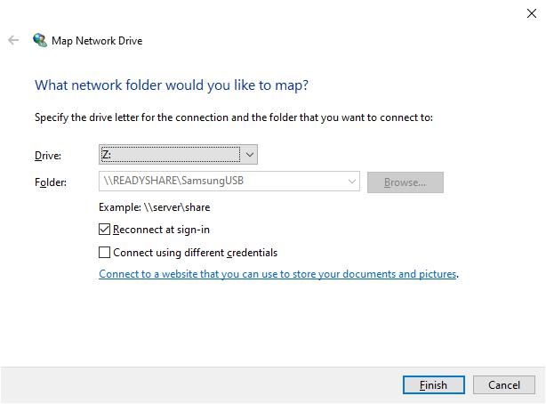

As I explained in my original post, I did eventually discover a way to connect. I have to find the share name of the USB device through the router interface. That is available through the Basic tab, Home page, click the Readyshare tile and it shows avaiable USB devices. The first column shows the share name.
Then it is simple to paste it into a run box and access the device. I am wondering though, is this the intended method for accessing a drive connected via USB to the R7000? Once I am connected of course, I know that I can map the drive.

Netgear is still stuck (on the routers, extenders, ...) to NetBIOS device discovery and name resolution, and most of these consumer devices don't support anything but SMB 1.0 transport protocol. Both requires having the SMB 1.0/CIFS Client feature installed on the Windows 10 system. Plus the network location must be set to a private - not public - network. So we're still waiting for current SAMBA sharing file system support, and the addition of WS-Discovery - and htis feature would not be required.
Once done so, the router READYSHARE (or however it was renamed) should show up in the Windows 10 Explorer in Network - from here you can browse to the shared folders, no need to find the configured shared folder names:
Sometimes, it does not show up immediately here, it can take a minute or so after connecting to the network. You can manually enter the \\readyshare (casing does not matter) in the Start menu or direct in the Windows Explorer.- MorelsJul 21, 2019Aspirant

If there is a USB device plugged in, then it is possible to access using \\R7000, (manual could have said \\router model, would have saved me a lot of time.) Or I can use the share name of the drive, \\share name.

As you said earlier, you can map a Readyshare drive to a Windows drive.
Usual "right click" way in.
Doesn't that do what you want?
