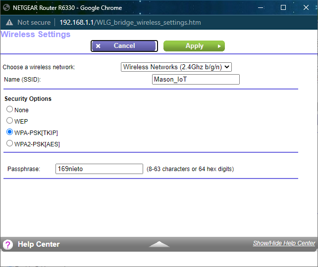

Bridge Mode on AC1600 Model R6330
 I'm back to trying to configure the router as a bridge. See attached steps I took. After completing these steps, the R6300 didn't seem to function as a bridge.
- Jul 24, 2021
I made a real "rookie" mistake during the configuraiton. I thought my home WiFi networked used WPA when in fact it was WPA-2. I had assumed the R6330 would give me an error when it didn't connected to the WiFi network and not show "Internet Staus: GOOD" on the main page. I've attached the steps used to get it configured properly for me that include screenshots.

- keithamasonJul 23, 2021Guide
I can connect to the R6330 either using routerlogin.net or the IP address (192.168.1.1).
It shows it’s in bridge mode (see screen shots attached)
And connected to my home WiFi network.
I tried pinging a specific IP address (172.217.14.78). This was the IP when I pinged google.com from my home network. When I tried pinging this same address when connected to the R6330 I got a “Destination net unreachable” error.
I’m unable to see the R6330 from my home network. In part I’m wondering if the issue is that the IP address for the R6330 is the same as my home router (i.e., 192.168.1.1). Is there a way to set the R6330 to use a different address?
I left the “Get IP Address Dynamically” and “Get DNS Server Address Dynamically” selected.

than you do.> SelectBridge Mode(from end of step 9)
> c. Clicked on "setup bride mode wireless settings"
> d. Entered SSID to bridge toAnd the appropriate "Security Option" (and passphrase)? I assume
that "None" (as shown) is the wrong answer.

> [...] I'd reset the thing, connect it to nothing except a
> computer with an Ethernet connection, and try it all again.Still my advice. And I wouldn't touch the wireless settings, other
than what's in the "setup bride mode wireless settings" pop-up. And I'd
be sure to set those to agree fully with the main router.What could go wrong?
