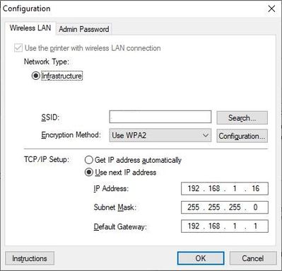

        You can also tell that to use a fixed IP address.
        Canon IP Address
        That's in the Canon utility.
        Some people like a belt and braces approach. Fix IP address on printer and reserve it on the router.
        The R7800 may exhibit this behaviour because your printer was previously associated with the old router.
