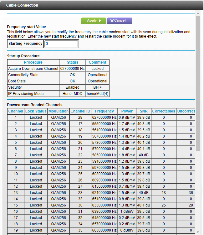

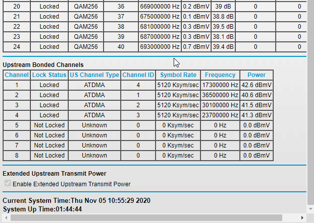

    do you have a screen snip of the cable connections page and the logs? That helps us to check the line.

      I've attached the screenshots for the Cable Screen.

      Not sure why, but the screenshots aren't showing so I'm including them as links for the Cable Screen. First reply has the first screenshot and this reply has the second half.

        You said theirs an amplifier in line?
        I'd remove that, move the modem to right where the coax enters the home, and try it.
        Reason why is that if the signal isn't good coming in, the amp just increases a bad signal.
        And if there's an amp issue, when the modem sends out a signal (upstream) it can block/cause issues.
        Do you have the modem logs as well? The cable connection page is just taken when you open the page. The logs show underlying/longer term issues.
