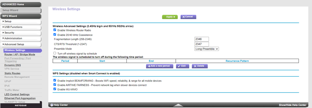

- robcampbellAspirant
I don't have Step 6 the way it's explained.
Once I set it to AP Mode and remove the wired connection to the Orbi, the wireless signal works but it is the original SSID and if I connect to it, I do not have access to the internet. Also, it is not accessible by the Orbi.

> I don't have Step 6 the way it's explained.If you _did_ want to configure the R8000P as a WAP, then you might
look in the R8000P User Manual for "Use the Router as a WiFi Access
Point". You'd want the "Router / AP / Bridge Mode" control, not
"Wireless Settings" on that ADVANCED > Advanced Settings page.Interestingly, although I found nothing relevant in the R8000P User
