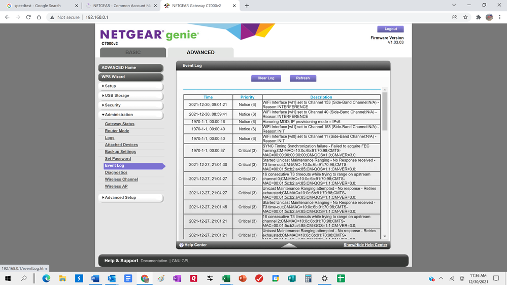

do you have a screen snip of the cable connections page and event log?- mpt1123Dec 30, 2021Tutor
Hello:
I get the same results when connect to the modem/router via CAT5 - about 118Mbs. I haven't made any changes to the config other than to change the 5ghz channel - which did not affect the speed. I've attached a screeshot of the log. I appreciate the help everyone has given.
Thanks.
