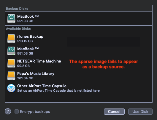

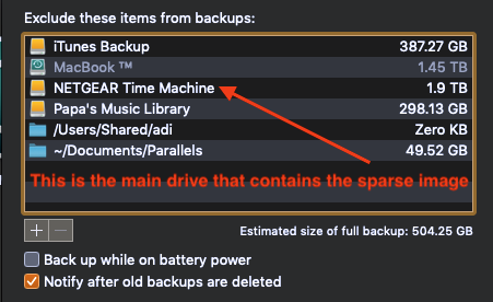

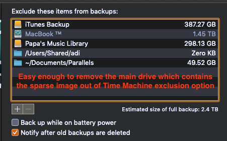

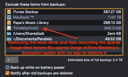

First I will comment that I am aware of your instruction to use Terminal to set the destination. However, since I already have one Time Machine backup running I was concerned that running the referenced Terminal command might muck up my current TM backup. Perhaps my cirumstance and request is too obscure for the purposes you have generously provided but I was hoping to learn one way or the other if I could make this work.
With respect to your questions to clarify what I was trying to describe I did intend to attach these pics the first time around:

I not exactly sure what you're trying to do, and the images are blank for me.
It sounds like you're either trying to have a 2nd Time Machine that backups up a source mac and 1st time machine setup, or have two Time Machines that your mac backs up to and alternates between them. I'm not sure if either of those setups are possible though I'm not really a Time Machine expert, so someone else may be able to comment.
I will tell you that the terminal command, `tmutil setdestination`, only lets Time Machine know it is a valid location for Time Machine to backup (it may set that as the default location as well, I'm not sure as I only have the 1 disk). It won't stop it from backing up to anywhere else.

I had the sparse image mounted and then ran the initial Terminal command. When I then went to Time Machine preferences it had selected the mounted sparse image as the Time Machine destination. I was now in a bit of a panic. While it would not erase my original Time Machine backup it would be somewhat challenging to re-connect the original Time Machine backup without losing all my backups.
Fortunately, as soon as I clicked the button to choose a backup disk I was immediately prompted by Time Machine to confirm if I wished to use the selected disk, my sparse image, or if I wanted to use both disks, the other being my existing Time Machine backup drive, and rotate between them. One hurdle avoided. I selected both then followed the rest of your guide for Step 4 - "Router Setup" and Step 5. "Mac Setup (aka Return of the Mac)."
