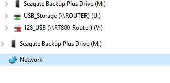

Can't see my Router in Windows Explorer
My Nighthawk was sharing files perfectly, but now I can't see the Router in Windows Explorer (Windows 10).
Has anyone else had this problem?
The "Network"...

When you run NET VIEW in a CMD prompt, do you get and error message or see ALL the PC's or other devices on the network?
You may need SMB1 running. Check if it is in a CMD prompt with sc.exe query mrxsmb10 and it will show if it is running or not.
Not running. Go to PROGRAM AND FEATURES and add it back in.
- JraddersJun 04, 2018Aspirant
Hi IrvSp,
I've added in SMB1 and I can now see the Router in Windoes Explorer. Thanks.
