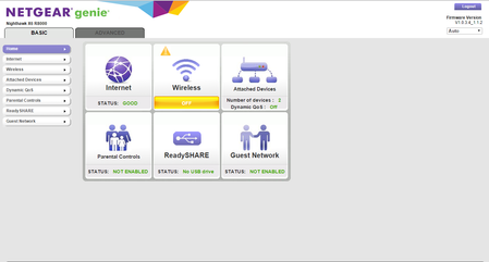

Can't turn on wireless
Today I updated the firmware on my Nighthawk X6. Since I've done so, it wont transmit a wireless signal. On the Netgear Genie, it says my wirelss is off, but when I click it, it's showing that everyt...

ok, i have reset and still dont have wireless, what should i do now?

- j_picFeb 09, 2016Guide
No, that was the first thing I checked. All lights are on, all options inside of router are checked to transmit. I just spent 2 hours on the phone with support with no solution. They have decided to replace the router. Thanks for the help everyone.
