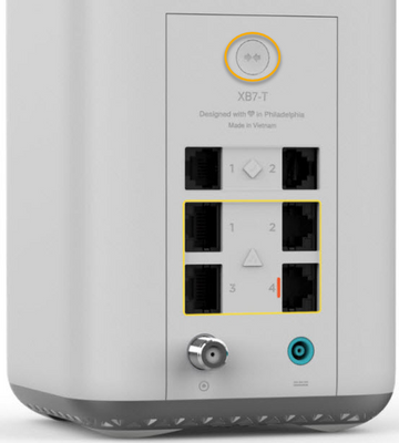

I'll try the solution you suggested, but I had to run the LAN directly from my box to the Comcast modem in order to get this page to even load. I'm pretty savvy on hardware, but the back end stuff is mysterious to me.Suggest you look a little more closely at the Comcast Gateway model number. Most likely molded into the plastic on the back side and you need to use a light to see it clearly. Most likely something like XB-6, XB-7, or XB-8.
The device should have three MAC addresses, one for the WAN input, one for the cable modem, and one for the phone MTA.
See attached for the back of an XB7-T. The T indicates made by Technicolor.
