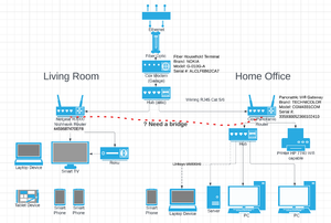

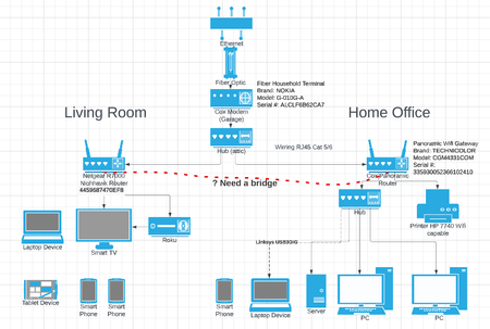

Connecting two networks, R7000 and Cox TECHNICOLOR CGM4331COM
Hello, For some reason I ended up having two networks because the signal was too weak and I was missing a hard wire connectivity. Now I would like to connect these two networks, Do I need hardware o...
Apr 11, 2023Guru - Experienced User
Remove the Technicolor router and install a 1GB LAN switch here or put in place a wireless AP in AP mode configuration which some have LAN ports in back. Use the R7000 as the main host router. Connect everything to the R7000 router.
